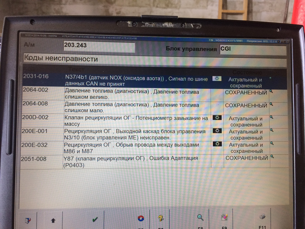

Yes, I have screenshot by only in Russian

You have possibility to read generic P code with commercial diagnostic pls?

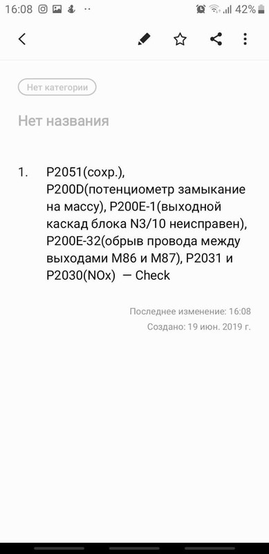

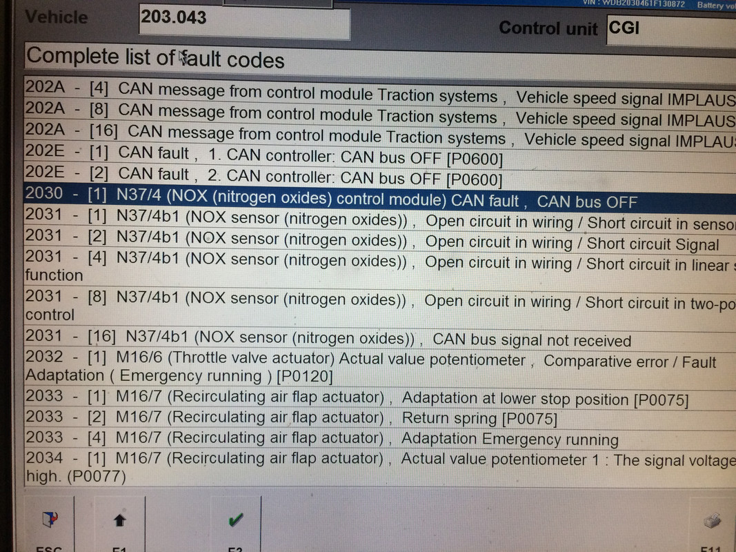

ECU with desoldered flash. Will try...
Customer some times ago read dtc with Autel Diaglink
As you can see error the same only w/o P

mate which vin is correct one?first fotto have 203.243 vin and 2nt 203.046?something strange here.

If it help you to solve task, on last photo DAS in simulation just to see all dtc. Also you can compare ID from fgtech, kess and von from first photo with actual dtc

problem looks as short circuit or ecu.check actual values B37 Acellerator sensor and kickdown switch.when B37 have short circuit it confiuse engine sensors.2nt-try to unplug one by one engine part component with malfunction.
