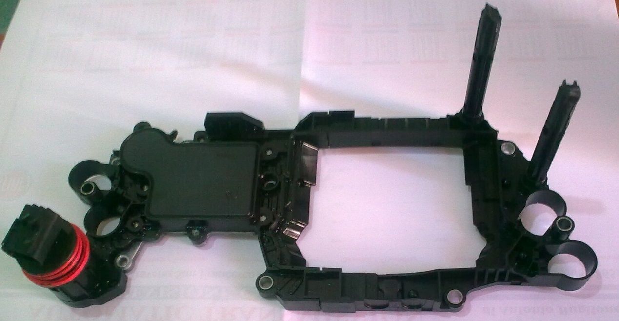

does anyone know what tool can clone a VGS FCVT ?
magprog 17x does not the job and only supports VGS2-FCVT
im talking about the one with black cover and i need to clone a module from A to module B so Not a map extraction
any ideas?

Why don't you try using DAS developer mode? I have used it a few times to transfer all codings from one module to another.
RE: clone a VGS FCVT B class ?? - sixcode - 10-24-2018
Ok thanks. I never use DAS but I will try it, I have a passthrough version here.
What steps do I need to do get the codigs transferred?
What about the software that I need in second module?
Also this all is on bench so I have no vehicle....
RE: clone a VGS FCVT B class ?? - mb_port - 10-24-2018
you must first erase code from donor,after can you coding
with star,5 minut job

im using star now and i get a message "cant transfer data to new unit" ?

can someone make a step by step txt file what to do in xentry to copy from module A to B on bench..
 in development mode on bench I get error " can't copy/download to new module" so i get a error downloading/extracting software from module A to begin with….
RE: clone a VGS FCVT B class ?? - Autotronic1 - 11-03-2018
Just read coding from old unit and with that code recode your new unit. I think software is same.
