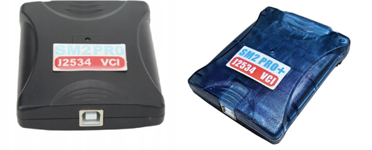

So maybe I will reveal an issue that might tell something yet still looking for an answer.
I know only there two clones of SM2 Pro:
[Image: 2025-04-20_16-53-38m.png]
on the left SM2 Pro  and  SM2 Pro+ (with plus) on the right. Both are HW version 2.21.22.
The +(plus) version has a K-Line on pin#7 which apparently the one left has not (or it is on pin #3)
So for which one of these two - the firmware attached here might work ??

Anyone know if its possible to add k-line on pin 7 to normal sm2?
39
(04-20-2025, 08:17 PM)Skilled_Tech Wrote: Anyone know if its possible to add k-line on pin 7 to normal sm2?
K-Line is simulated on pin #3 - just make solder bridge between 3 and 7.

so if i want to upgrade my Black SM2 , i can use this firmware but need to bridge pins 3 + 7?
42
(05-08-2025, 04:28 PM)nickscarpenter Wrote: so if i want to upgrade my Black SM2 , i can use this firmware but need to bridge pins 3 + 7?
The previous post mentioning to bridge pins 3 & 7 was in relation to K-line.
"K-Line is simulated on pin #3 - just make solder bridge between 3 and 7."
You find everything you need to upgrade the firmware here >>> Firmware 2.21.32

I understand that, what I meant was if i upgrade my black sm2pro,  I will also need to bridge pins 3-7 for kline based comms to work?
